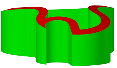

You are going to have to sketch for me. I can't personally see at any time a point in which the outer edge of any cutaway would be closer to the center axis of the sphere. And that is the only thing that determines elevation (distance from the center axis of the sphere to the contact point on that sphere).
Give ma a sketch of what you are talking about and I be I will prove you to be over thinning the issue

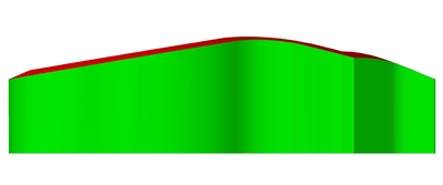

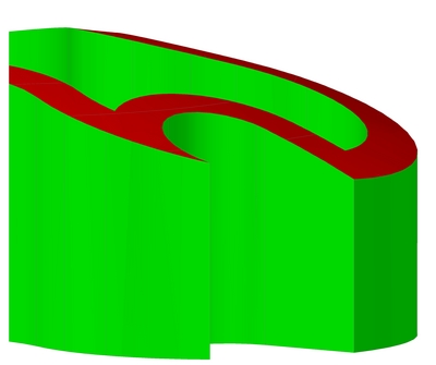

Give me a sketch or a phoo of the type of cutawy you refer to and I will model it for you.
I think you are thinking in only one axis. It is not nessasaraly the point closest in the "X" axis that is the closest to the center axis of the dome. it is the closest on a straight line regardles to axis.
This what I think you mean but see even though the outer or upper bout portion of the cutaway is closer to the center axis of the dome in the "X" axis it is much further away from the domes center axis in the "Y" axis therfore the inside curve of the cutaway is still closer to the center axis of the dome.

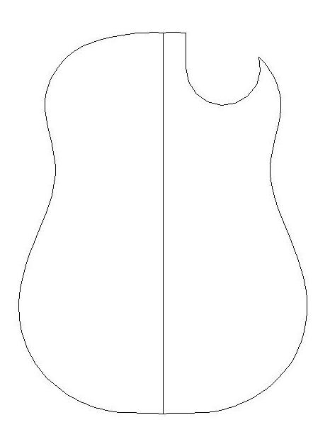

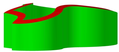

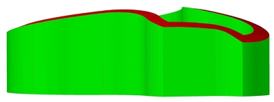

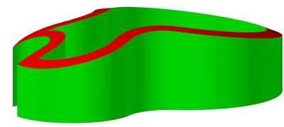

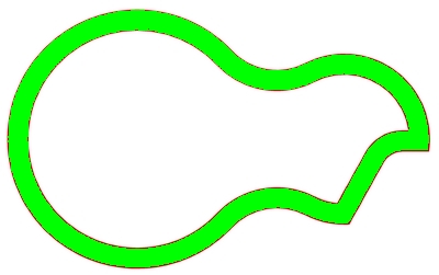

OK Howard had almost convinced me that if the cutaway was past 90deg toward the center of the body that there would be a negative angle formed by the dome in the linings. But it just did not make sense to my 3d over loaded mind. So I ran another 3d model test with a cutaway that the cutaway was way more than 90 Des toward the center of the body. I want to be clear here I did not do this to prove anyone wrong. I did it to prove to my self that I was thinking correctly. I started not to post it but thought it worth while.
And just as my mind was telling me no negative or declining angles just different elevations.

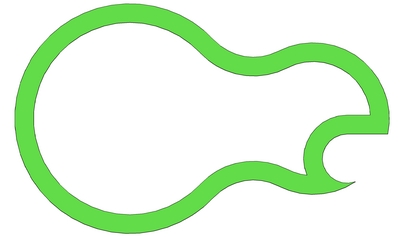

PostPosted: Thu Oct 11, 2007 6:04 am
Posts: 493
Like This?

PostPosted: Thu Oct 11, 2007 6:48 am

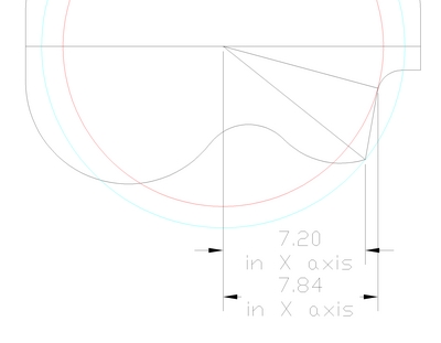

Still no declining angle
It ain't going to happen guys The dome shape will always form an inclining angle pointing at the center axis of the dome, unless the depth of the cutaway goes past the center axis of the dome. And we know that ain't going to happen. and even the the angle is inclining relative to the dome. Even then, it would be on other side of center axis point at the center axis so it is still inclining when view from the proper side of the center axis

You are correct no one questioned that. Some just thought that if the hook was more than 90 degrees the angle formed in the linings would decline rather than incline. The radius will always match the dome and the linings will always be higher on the inside of the rim that on the outside. The only thing that changes is the elevation relative to a given plane. That is what I have been saying all along.
PostPosted: Thu Oct 11, 2007 8:06 am
it will still incline as viewed from outside the guitar or F mandeline in your point. Just at different elevations from a given horizontal plane. The inside of the lining will always be taller from a given horizontal plane than the outside of the rim.

In truth, Michael, I was picturing my own system of arching the top laterally only. But I did say doming. And you are right--a cutaway would have to hook around past 90? to a line radiating from the center of the spherical dome to get a negative slant on its top, and that would be over a tiny area.
